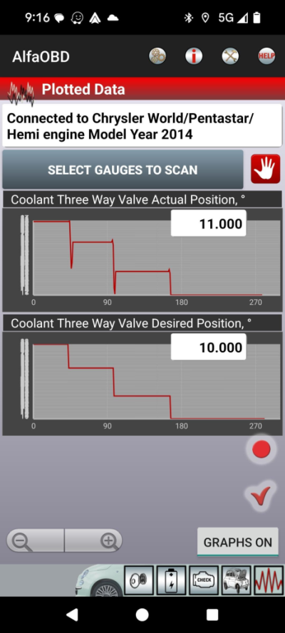

Ecodiesel 3.0
Trying to troubleshoot a no-heat issue and have found the heater core hoses are not getting hot. I wanted to test the valve positions, and @SitKneelBend sent me a screenshot of his truck with hemi, which has the two options I'm looking for. Still, I can't find them. Any ideas? We are also trying to troubleshoot whether the HVAC system is commanding the valve to turn on, as we are performing a 5th-gen 12.1 swap into a 4th-gen vehicle. We are specifically looking for these test menus. I also posted this in the Eco Forum, but I'm hoping maybe this is a general Alfa thing I'm missing, thanks!
