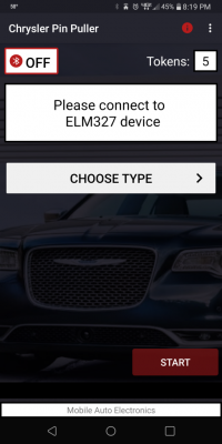

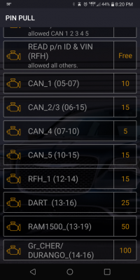

got Alfa OBD yesterday and found though other thread on alfa OBD that resetting tire pressure Threshold was not going to be all you need to clear the alarm and PITA tire screen coming up at every start up. sort of new this cause my autel scanner reset the threshold but still had a alarm. anyway found out the RFH has A pin Access well I did not want to mess with any dealers so I run across a older post in this group actually but for those that has not seen it there is this great little app Called (Chrysler pin puller) screen shots below its like 50 tokens which is 14.99 And I got my pin myself and got alarms turned off for anyone looking to avoid dealers or just has dealers that refuse to give it.
here you go. worked great for me and would pay again to avoid trying to get to a dealer
