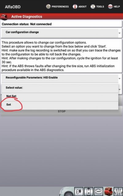

Digging this thread up. I’m not seeing where LED is an option in the 2012. Is there a work around to this? Also I don’t think LED was a factory option back then. I’m curious to know what other feature changes can be done pre 2013
Follow the instructions to enable HID and it will work for both HID’s and LED’s for all 09-12 Rams. Enabling the HID option will disable the trucks PWM which is what causes issues with lighting.

So would I enable hid and disable bi xenon? Is there anything that can be configured for the rear taillights/turn signal
All you need to do is follow these steps. Do not disable anything or change anything else. Simply follow the following steps.
