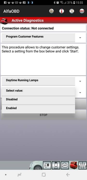

Mine just gives me enable or disable drls. I set it to enable and it confirmed it but they still dont come on.

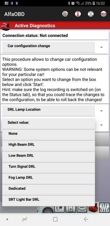

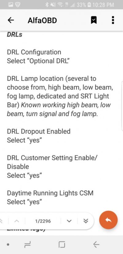

So you didn’t see anything of the following?
DRL Configuration
Select “Optional DRL”
DRL Lamp location (several to choose from, high beam, low beam, fog lamp)
DRL Dropout Enabled
Select “yes”
DRL Customer Setting Enable/Disable
Select “yes”
Daytime Running Lights CSM
Select “yes”

This is more than likely the problem.

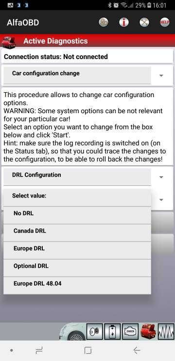

Are you sure you went all the way to the bottom and clicked car configuration it's the very last item
Ghost_RAM
Ghost_RAM
Jan 10, 2018
1,367
1,099
VA
Sent from my SM-N950U using Tapatalk
Back out of program customer features and scroll to the bottom to car configuration change.

Think I found it. Never went I to that screen and really read everything.6d814117dbcbb56a9e199592dc18ab9b.jpgcbebdcdd9102aa06a935b8bcb7ba78df.jpg61a80b99f9d92eb8cef569f4c0a564b2.jpg

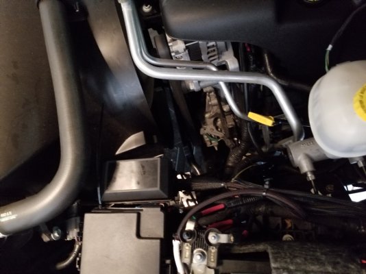

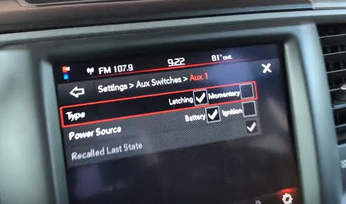

Finally installed my Aux Panel/Switch and Relay box, plus the trailer controller. Man what a... well pita is the only word really. I could not for the life of me get the relay box mounted on the firewall like most suggest. There was just too much angle for me to get any bite with self tapping screws. After almost an hour of trying different drills/extensions/etc I finally said uncle and found a different spot.
So the tray that holds the fuse box/center next to the battery conveniently had one hole available, I utilized it and drilled a second hole. But, I wasn't able to get a good nut on the back side, so had to resort to the cable tie for now. I'll make a trip to the hardware store to see what I can come up with.
Everything else went ok - I used the clutch delete plate and one of those universal firewall grommets to run the wire through, and added the trailer brake controller at the same time.
AlfaOBD made quick work of the trailer brake, and I just set the Aux options as well and am letting it sleep.
The only issue I've run across is buttons 1 and 2 do not come on unless the key is turned (like 3,4,5). They are supposed to be hot at all times. I haven't installed any fuses yet in the relay box, not sure if the fuses need to be installed for them to work sans key. I'll also check the config after it sleeps as I saw in CBG's vid that it has the option to set them to battery or ignition.
CustomBlackGunz vid...
EDIT - not sure this location is going to work out - did a quick errand/test run and when I got home the box was really, really warm. Not sure how warm it would be comparatively at the firewall, but it really seemed warm where i have it now. So back to the drawing board on location I guess. :(
Could someone who has theirs mounted on the Firewall check theirs after driving for a bit? Mine gets too almost too hot to hold my hand against for more than a few seconds in it's current location.
