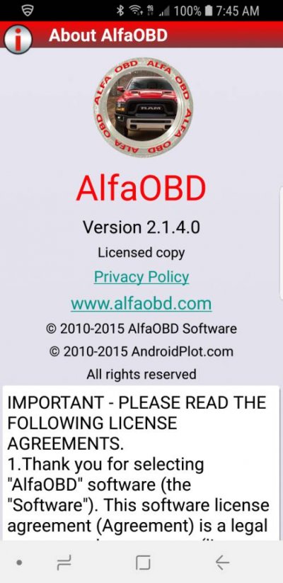

Mine doesn't update automatically like some of my other Apps. If you go to the Google Play Store and bring up the alpha OBD app it will tell you if an update is available. When you actually have the app open If you press the ! Icon on the top of the screen it will bring up the version that you currently have loaded.fdfdcbe4c583960244e998e9bd12bb84.jpg
Thanks, I did just what you said and yes I have the most recent version. I also clicked on the 3 little dots in the upper right corner in the Play Store for the AlfaOBD app and found a little green box with a check mark next to "Enable auto update".

Thanks, I did just what you said and yes I have the most recent version. I also clicked the the 3 little dots in the upper right corner in the Play Store for the AlfaOBD app and found a little green box with a check mark next to "Enable auto update".
I have mine checked as well but for some reason it doesn't update automatically. You might want to check the play store every so often just to make sure yours is updating.
