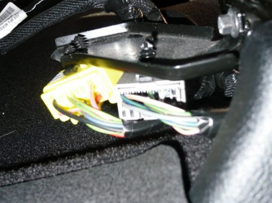

mjf6175 not sure if you have done this or not but check your drivers side yellow seat plug. Do you have a VT/YL wire in pin#2 and a VT/BR wire in pin#13? If you do that is the wiring that connects your Memory Seat Module to your CAN system. I didn't have the factory heated seat wiring so I installed a harness from M2mods. I later added the wiring from the #2 and#13 pin to the CAN. I turned on the memory seat module and the easy exit seat with the alpha tool and it now the easy exit seat works and I can connect to my memory seat module with the alpha Tool. I also ran the correct wiring to the door module from the drivers side seat plug and still could not get the actual memory seat function to work with the alpha OBD or the AE tool. This may not be the case for you but the first thing I would check is to see if pins#2 and#13 are pupulated on your drivers side yellow seat plug if you haven't already . If they are I would feel confident that the rest of the correct wiring is present. I have seen some cases were the memory function just won't work in certain trucks no matter what tool is used. That being said if you have the correct wiring and activated the memory seat module plus the easy exit seat with the alpha tool it should work as it has worked on other trucks including mine. You may try the AE tool but as many have said be careful with it and only turn on codes that have been verified ok. It can make a mess if you turn on the wrong codes.

mjf6175 did your truck come from the factory with the correct wiring for the heated seats or did you install the heated seat harness?
Hey Rick.....my 2017 2500 Regular Cab came with the wiring, just bolted in the seats, plugged in the harnesses and made the bcm changes. My Ram originally had the deluxe cloth buckets which is 10 way power only on the driver's side, manual seat on passenger side. But the wiring was all there. I also had factory wiring in place for the ATC mod, just plugged in the temperature sensor and again made the bcm changes. The "no-need" to do wiring was repeated when I added the Smart Beam mirror, the stock one was an Auto Dim / Assist / 911. Just changed out the mirror. So far with the many changes I have made I have been lucky since I have an RC and as you mentioned awhile ago RC's have a chance to have more wiring than not. The only time I was "missing" a wire was when I added the backup camera. I used the harness from Mike Grimm from the tailgate to the connector behind the driver's wheel. That should have been it. But strangely I was missing ONE wire from that connector to the PDC (for power), and that is the only wire that my RC has been missing so far (yes I will jinx myself). So I am keeping my fingers crossed that wiring is there once again.
I have an AE enroute to me that I rented from Tracy on the Cummins forum. I need to set the setting for the "Memory Seat Module (MSM)" which is not the same as the setting "Memory Seat Present ". I have already "set" 5 settings for the memory function, the MSM setting will be the 6th. I will of course post up just what happens. Thanks for your help as well as Ghost_Ram.

Hey Rick.....my 2017 2500 Regular Cab came with the wiring, just bolted in the seats, plugged in the harnesses and made the bcm changes. My Ram originally had the deluxe cloth buckets which is 10 way power only on the driver's side, manual seat on passenger side. But the wiring was all there. I also had factory wiring in place for the ATC mod, just plugged in the temperature sensor and again made the bcm changes. The "no-need" to do wiring was repeated when I added the Smart Beam mirror, the stock one was an Auto Dim / Assist / 911. Just changed out the mirror. So far with the many changes I have made I have been lucky since I have an RC and as you mentioned awhile ago RC's have a chance to have more wiring than not. The only time I was "missing" a wire was when I added the cargo camera. I used the harness from Mike Grimm from the tailgate to the connector behind the driver's wheel. That should have been it. But strangely I was missing ONE wire from that connector to the PDC (for power), and that is the only wire that my RC has been missing so far (yes I will jinx myself). So I am keeping my fingers crossed that wiring is there once again.
Sounds like you definitely have the wiring. I am not sure why the alpha tool didn't work to enable you easy exit seat but you never know. Good luck let us know how it goes and like I said be careful with the AE tool.

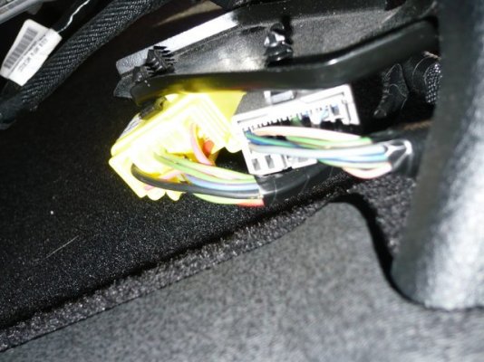

Rick...I pasted below pictures of my yellow plug under the driver's seat. I took the pic way back before I did the addition of heated/ventilated seats. Can you tell from these?
413315[/ATTACH]']Sz66VBjl.jpg
413317[/ATTACH]']WPvyTIMl.jpg
