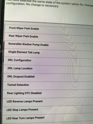

Had some time today so I paired up the obdmx and alfaobd and looked around. Since I’m a beginner at this, I just made 3 changes so far:
1. Fog light dropout
2. SRT screen
3. Changed front Fogs to LED
Everything worked great. I have the Morimoto led fogs with 2 huge resistors on each one. After the configuration changes I plugged the factory plug directly to the fogs and drove for an hour without any resistors, I didn’t get any errors messages so that’s great imo.
One question I have is on the DRLs, I looked customer setting for the setting that would enable them to turn on and off on the 8.4 but I didn’t see that option, did I miss it?
These are the only DRL I saw
2. SRT screen
There is one more setting: "DAYTIME RUNNING LIGHTS CSM" its lower down on the list of settings. Counting this setting there are 5 total for DRL's. See post #1

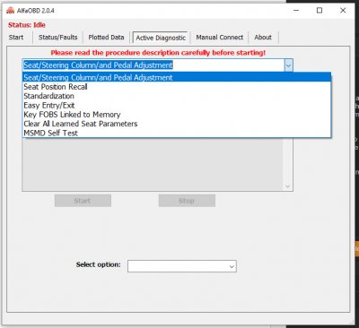

Yes. I was NOT able to find the 2 settings in ALFAOBD, so I did in fact set them with the A E Tool
I have also connected to the Drive Seat module with ALFAOBD and there are no settings in there, only ability to test functions (no need for blue adapter when using OBDLink MX)
Ya I saw that on post 1, just didn’t see it on my selection lol
I’ll scroll thru slower, like I said I’m a beginner
It’s about 3/4 of the way to the bottom with the rest of the options that have CSM at the end of them

Chamolie....thanks for your response! A couple more questions and observations.
I use the Alpha program on an Android tablet. When I go to the "DRIVER SEAT" file I get 4 listings and I go to "Memory Seat Module (Use Blue Adapter)". When I go to that setting I get the same 7 choices you show in your screen shot (with an exception explained below).
If I go to "Seat Position Recall" (the second setting on the list of 7 in your screen shot), the next page that shows up there is a text box stating: "This will actuate the memory seat based on current user settings. You will not be able to run this actuator if the memory seat profiles are not set or the Easy Entry / Exit is not enabled". Then under this text box is the drop down menu where you select an option, I get 3 choices:
-"To Easy Entry / Exit position"
-"Position 1"
-"Position 2"
Also if I go to "Easy Entry / Exit" (the fourth setting in your screen shot) the text box on the next page says " Use this function for enabling the Easy Entry Exit option on the driver's front seat". Then select "Disable" or "Enabled"
You did not see these settings when using the Alpha? Maybe because you are using Windows? I am a complete NOOB in all this stuff, so half the time I am flying blind. It just seems that on the android version I get choices to activate? Do I go to all 3 settings ("To Easy Entry / Exit position" "Position 1" "Position 2 ) one at a time and then hit "START"?
If I was somewhat braver I would just try it, but having already gone to the dealer once for a reflash of the BCM I am of course more cautious and look for your, and others, help and input. Thanks!
chamolie
Jun 18, 2017
73
37
2016 SLT
Cummins 6.7
-"Position 1"
-"Position 2"
Yes, I do have the same 3 options and have tested them:
To Easy Entry / Exit Position - will move the seat all of the way to the back (assuming you have Easy Entry / Exit functioning and enabled in CSM - setting in Radio)
To Position 1 - will move the seat to the position that is programmed for Memory 1 on the side of your driver seat (assuming that you have the memory seats functioning)
To Position 2 - will move the seat to the position that is programmed for Memory 2 on the side of your driver seat (assuming that you have the memory seats functioning)
ALL 3 settings are for testing, they DO NOT enable the feature
The 2 options:
"Easy Entry/Exit" and "Key Fobs Linked To Memory"
will enable/disable the feature as if selecting from the settings menu in the Radio
I have testing all options within the menu for the "Driver Seat" and all have worked, I even successfully installed power adjustable pedals from ebay
