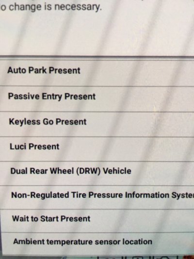

@Mpgrimm2
Took another look and there’s the Auto Park Present and Auto Park CSM. Have you looked to see in the body computer if they are both selected on your truck? I would think the Auto Park CSM would be the one people wanted to enable/disable the auto park feature on the fly. Being CSM would it be as harmful as some others?

@Mpgrimm2
Auto Park CSM is "not set" on my truck ... hmm
