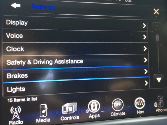

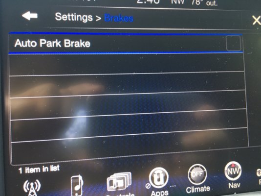

Auto Park CSM is "not set" on my truck ... hmm
M² Mods.
Ok, here is what Auto Park CSM sets on my 8.4.
Can’t select it of course because I didn’t enable the other settings. Probably won’t work on mine anyway as I don’t think this is for the thing we’re thinking of...?
Edit: Went back and looked at the Auto Park Present and it was set when it wasn't before. Think it enabled it because I enabled the CSM setting for it? I know it definitely wasn't set before I set the CSM, I even verified in my logs. Going to experiment by disabling the CSM then the setting and doing it in the correct order to see what happens.
