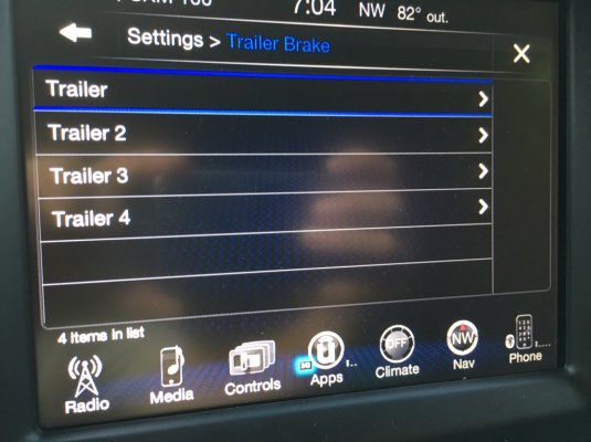

I can not verify if it actually works as I don’t have the module installed. But, settings display on evic and 8.4
Trailer select csm
Select “yes”
Trailer name csm
Select “yes”
Trailer type csm
Select “yes”
ITBM/HWM integrated trailer brake module
Select “enable”

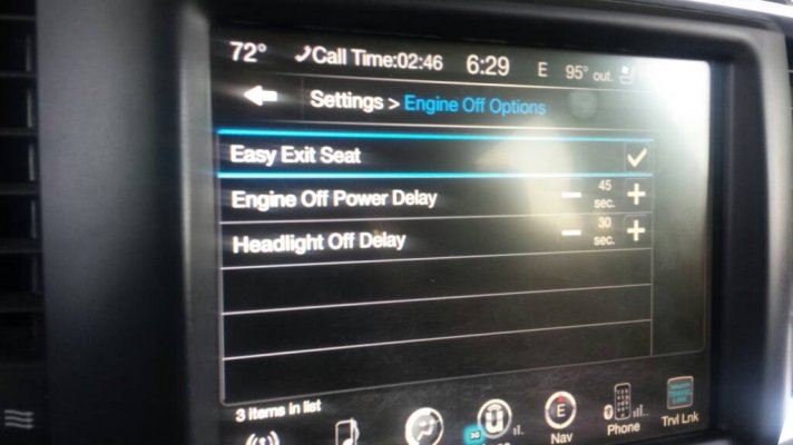

STecoD and I have been playing around a little trying to get the memory to work in our Laramie seats. We haven't had much luck getting the memory to function but we have had some success with the easy out seat setting. We enabled the seat memory and the easy out seat function in the CSM menue. Mine seems to work well. StecoD seemed to get his working but then his stopped. When I turn off the key my seat moves all the way back. When I get back and turn on the ignition the seat moves back to where I had it previously set. We have both gone into the memory seat module and try to adjust the parameters to get the memory seats to work but it keeps saying that is not within the correct parameters and it fails a test. We both hooked our memory seat modules up to the CAN system via a harness DeereGuy made for us that goes from the CAN to pins five and six in the yellow seat plug. Not quite sure why the module won't adjust itself or work but we will keep playing with it. 84aebd2ada9f1982e5ad77241e6bf654.jpg
Trailer select csm
Select “yes”
Trailer name csm
Select “yes”
Trailer type csm
Select “yes”
Select “enable”
3a254de7dd3ff2f955fad29ef4884205.jpg392cb193b3d7bbaf4dbc152fb8120e14.jpg44bb731f09f4085de4105bc0bf2422c7.jpg42c9a74ccde6e06f0e136ee7212b223f.jpg26cd40b5f3328efb15f3c095c7bff735.jpg
This is the same thing I did for mine, and I can confirm it does work on my 18 2500 tradesman.
