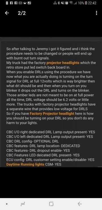

Yes -- I figured out a trick to tell the difference.
With the proper setup:
1) CBC I/O right dedicated DRL Lamp output present- YES
2) CBC I/O left dedicated DRL Lamp output present- YES
3) CBC features- DRL lamp location- DEDICATED
4) CBC Features LED dedicated DRL present- YES
If you turn on the turn signal, it will BRIGHTEN slightly from the DRL brightness when the blinks commence. There will be DRL illumination, then a flash of slightly brighter light just as you hit the turn signal stalk. I think it's only about 10% brighter in spite of what people say. I think the dedicated DRL turn signals are 90% as bright as using the non-dedicated DRL method (as listed below).
