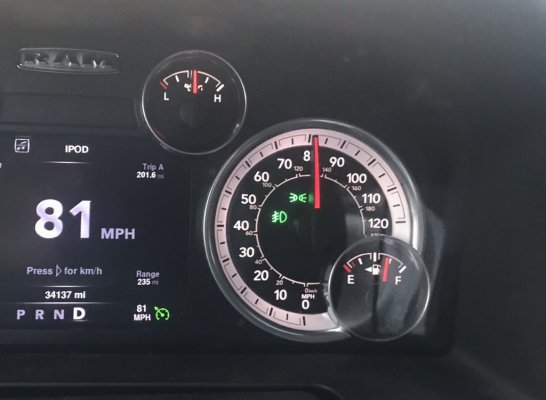

I left the calibration completely alone and changed the tank size only. I am 3 fill-ups in and it is working great. Take the truck to 0 DTE and it has taken right at 29.5gal each time. I am good with a 2.5gal reserve. DTE is correct. Averaging 14.7mpg my truck is showing this. Calculates out to right at 29.5. Tank is showing just over half full, picture is taken at an angle and shows more than straight on.

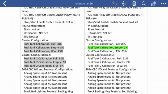

I had set the full on mine to 98% a week or so ago and I distinctly remember it making a difference in the gauge reading, but after seeing your post I went out and double checked. Sure enough, it was back to 91%. I set it to 98% again, shut it down for a bit and checked again. Back to 91% again. This is with the latest Android version and an MX dongle. Has anyone gotten the setting to stick?
-K
I will check mine in a little bit. If I recall, I was one of the first to actually get the settings to take and be functional; to be honest I have never gone back and re-checked, since I confirmed (in my case at least) that those settings actually took, and worked.
And come to find out that it seems to have reverted to the 91% setting, yet maintained the 2% low/empty setting. Interesting. I reset it to 98% so I'll see how it goes through the day.

I was able to get the empty to go to 2%. I have full set at 98% and empty at 2%. I haven't messed with the LFW. Anyone have an idea what it is?
