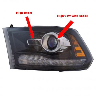

I'm not sure the factory projectors can work that way. Iirc they are bi-funcional so they use a solenoid and a motor to bring down a "shade" that obstructs the light in such a manner that it turns low to high beam.
If that's true, using high beam as DRL would be the same as having your high beams on at all times.
Actually, that's half correct. :) It does do that on the low beam side, the actual projector, but there is also a separate high beam reflector based bulb in there. When you turn on your high beam, the reflector bulb goes on and the projector raises the shade out of the way of the low beam bulb allowing it's full light to be used. The High Beam DRL is supposed to run that separate reflector bulb on half power.
Like this:
Like this:
-K
I 100% agree with this. There is no "rule" saying they can't simply illuminate the high beam bulb in the projector headlight without activating the shutter. It wouldn't be the full "literal" high beam experience with DRL's -- just the high beam bulb at a lower wattage. On top of that, I could have sworn I saw this behavior in action. I just need to try to reproduce. ;)
Like this:
-K
The toyota cars use the halogen high beam on a pwm to limit that voltage like your saying. When the bulb is switched to LED a pwm module has to be added to replicate the DRL mode.
Sounds back words with this software but that could be an option to get it to work on the ram?
The other thing is if certain equipment like projectors for example override Alfa then you have to use mechanical equipment to beat it.

OK -- I was mistaken. I cannot make the high beam bulbs illuminate as DRL's with factory projector fixtures.
Procedure: First, I ROLLED BACK all the dedicated settings:
1) CBC I/O right dedicated DRL Lamp output present- YES --> NO
2) CBC I/O left dedicated DRL Lamp output present- YES --> NO
3) CBC features- DRL lamp location- DEDICATED --> High Beam
4) CBC Features LED dedicated DRL present- YES --> NO
High beams do not illuminate for me...
I could make FOGS, TURN SIGNALS (the "incorrect way" with brighter LED's) and LOW BEAMS come on as DRL's by toggling #3 above. But not HIGH BEAMS.
Interesting!
-Guzzler
