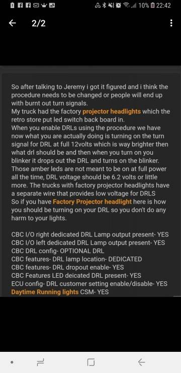

Sent from my SM-N950U using Tapatalk
mike19950
Sep 5, 2017
233
209
Delaware
I don't have projectors. I turned on all the settings in the Google drive doc.
