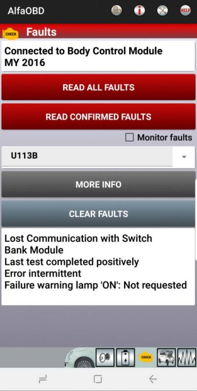

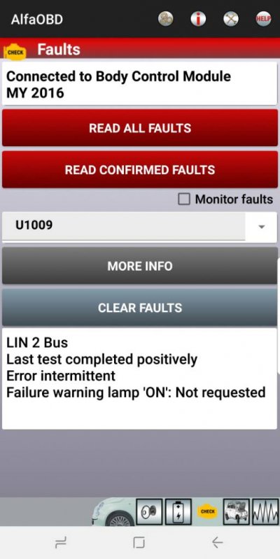

Keep seeing these two faults under BCM with no noticable problems. Don't believe anything has been touched or changed since I have received these codes. Didn't have these months ago after installing the auxiliary switch panel. Really wish I could roll back time and screen record all my changes.
Don't have any ideas on what is causing the codes. Any help would be greatly appreciated. 85ea2b27cb094ab646d47a70b627132e.jpg370665409cab972f3758a8ffee9d24e2.jpg

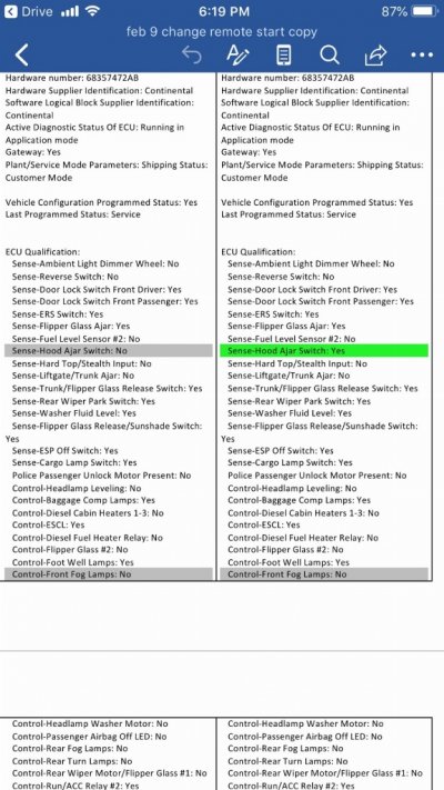

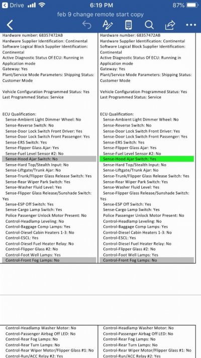

If you have enabled logging in the alphaobd app and have it connected to a Google drive account you can send the logs to drive and verify what's been changed. It stacks the logs on top of each other so your first log will be the first you see and do the last will be your current. It'll take time going through and seeing what you have changed but you may find something. What I find to be the easiest for comparison is start with a word document insert 2 columns and copy and paste the previous log next to the current log to compare changes.

Thanks man I will try that next day I get some time. I don't feel like I have anything messed up anymore it was all fixed months ago just don't understand why I now have these codes.

Hard to say could be a loose wire/connection or ground

First go to settings, and select LOG RECORDING then Look for either a tools icon or tools tab. I always click VIEW FAULTS AND STATUS LOG first then back to the previous screen and select UPLOAD TO GOOGLE DRIVE, UPLOAD FAULTS AND STATUS LOG, select BODY_CHRYSLER_INFO, enter whatever you want to save it as, I always save it as the date and what I changed for easy reference.
Edit. The steps should be the same for windows
