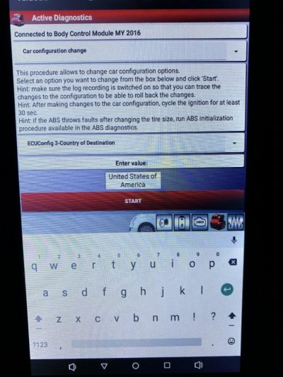

I am on version 2.1.6.6 and have not installed the latest update that came out yesterday. I also show the country of destination as a value in my android. So if something got messed up it happened before the latest update. d811a845445554f24be1a8daf999bb31.jpg

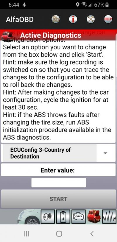

I’m curious if @Michael Dent can tap the box and pull up the keyboard. rvnpSi8.jpg This is the updated version yesterday, and it’s still called 2.1.6.6
I went ahead and tried this. Says something about value not being correct
