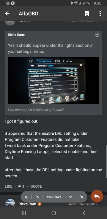

Yes... the post I referred to talked about choosing OPTIONAL, to make it work.
Also, check these settings:
CBC Features - DRL - OPTIONAL (already done)
ECU3 DRL Customer Setting - YES
Customer Set Menus - YES
Search this thread for: DRL Menu
You'll get a lot of results talking about this.
Check out the post, in the picture. It's post number 6239.

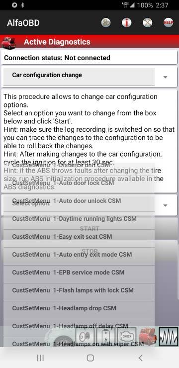

I can not find Customer Set Menus - YES ?
Thanks and greetings,
Erik
Car Configuration Change
CustSetMenu 1- Daytime Running Lights CSM -YES

Thanks for the picture, I do not see that in the Body computer MY2013=2017?
Only in the Body computer MY2014 Powernet?
Erik
Well... mine is in the MY2015 PowerNet
