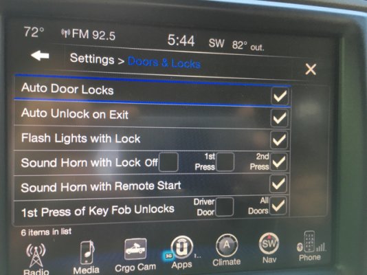

Has anyone found a way to adjust the settings for their OEM remote start? In my old Ford, I could adjust the duration the truck would run for from 5-15 minutes as well as whether or not the horn would sound. On this Ram, it seems there are no user adjustable settings. Has anyone come across a CSM setting that allows adjustment? Or am I just missing where I need to go for these changes? Be nice if I could disable the horn honk on remote start.
Dealer programmed my remote start. These are the only settings I have on the radio. Not sure about in Alfa?
