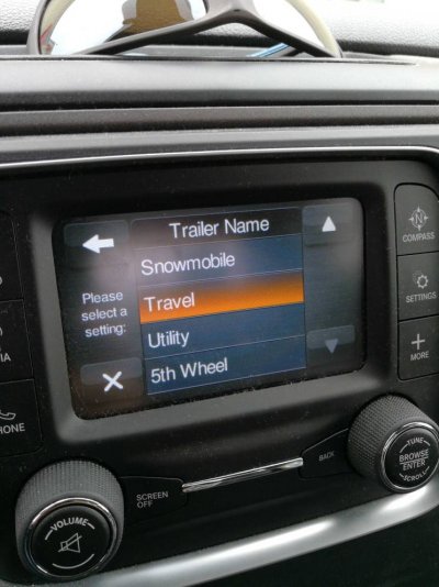

So had a similar issue with the 'Trailer Name CSM' setting. I can see the new menu items, and select a name, but it doesn't update the display. [emoji20]e8bf5564e667ab3d0f9dcf9c0226821e.jpg4fbb553b38543cbdb0f9cf65d20e0016.jpg
