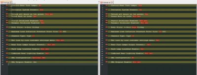

Post your newest log. I'll compare it with mine.

Well, I was able to change it to "Control-Rear Turn Lamps: No" but still no turn signals. I'm going to let it sit overnight and see if it's good in the morning.
I REALLY appreciate all of your help guys, and I'm sorry to have taken up so much of your time tonight. And I promise you, I'm not really as stupid as you probably think!
You'll probably notice "Rear Turn Lamps Output Present: Set" is different than what you have. That was one of my troubleshooting steps tonight and it's now "Rear Turn Lamps Output Present: Not Set".
Hopefully that was the fix.

SWEET! Thanks again for doing that. I’ll check my truck shortly and go from there. I hate clogging up this thread with my issue though.
EDIT: No luck, still no rear turn signals today... Fuse check next, then who knows.

Well, still no luck. I disconnected the batteries for about 30 minutes to see if that would help and it didn't. Still no rear turn signals or rear hazards.
I honestly don't know what you could have inadvertently set with the tool to cause this problem. If you have checked all your fuses and relays and you know they're good and your front turn signals work and your front Hazards work but you have nothing in the rear as a last resort you could take the truck to the dealer and have it reflashed. This will put it exactly to the stock configuration. You can work forward from there. Back when we were using the AE tool it would change codes on its own and we would be unable to put them back. I've actually had to take my truck in twice and have it reflashed and start over.

@Outbreak Will you upload another fresh copy of your config again with where you stand now? Thanks
