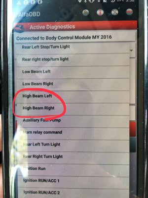

Anyone that has a ram with oem projectors, can you test something for me?
On the settings were you can turn on a single headlight or tail light, can you see if you can activate the headlight high beam solenoid with the Alfa software?
I converted my headlight harness from oem quad to oem projector and when I turn my high beams on, the projector solenoid doesn’t activate.
Thanks
Thanks
I have factory projectors and I can turn the high beams on with the test functions in AlphaOBD, but I'm not sure what you mean by solenoid?
I did a post recently in this thread with a list of all the test functions that worked on my truck, the specific test names are there.

I believe the solenoid is the shutter for the high beams and yes there is a test for left and right. Haven’t tried it myself but have seen it.

Ah. There was a conversation somewhere on the forum recently about that and I'm fairly certain that the conclusion was that neither the high or low beams on the factory projectors have shutters. The high beam is a simple reflector with no moving parts and the low beam projector lens also has none. A number of people who have disassembled the lights to upgrade or repair parts chimed in on the subject. If that's correct then the shutter test would fall into the "function for a different vehicle that uses the same BCM" category that we see a bunch of in Alpha.

I meant the low beam shutter. Mine came off a 16’ Laramie and they have a shutter that drops when the high beams are off. When engaging the high beams it raises.

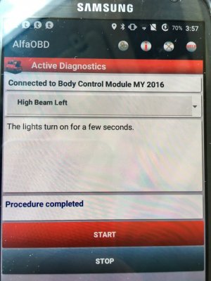

Mine was in run-engine-off position with everything off and in the first drop down menu of the BCM. Same page as program customer features (but not in program customer features). I did not try right or left high beam shutter. I knew I had seen shutter somewhere but I doubt it will work. The shutters are on the low beams, not sure if that makes a difference or not. I was testing by triggering high beam left and high beam right to get the solenoid to move.
I had figured out that the shutters were in the low beam, but I was working on the theory that "High Beam Shutter" meant "The shutter in the low beam that moves when the high beams are turned on". I'll check again after work and see if I hear any noises when I use the High Beam test sequence. It should be getting dark by then and somewhat easier to see the results.
