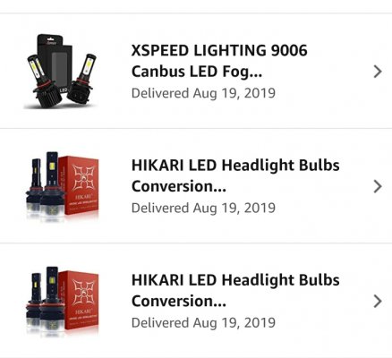

This is the low, high beams and fogs leds im using, did not change anything at all and all i did was enable drl with low beams no issues at all9c8fe31a7f35f10ef6b6af6d3bf5e81a.jpg
Sent from my GM1915 using Tapatalk
I used those in my low beams. I didn't have to make any changes with alphaodb. They were just plug and play without any issues. And they were reasonably priced too.
How long have you been running that setup trouble free?
