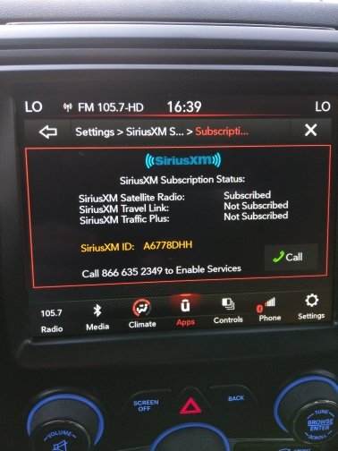

Ok, I've tried searching through here but I'm not finding any quick answers. I just installed a UAS Uconnect radio and want to get the Auto Climate Dual Zone off the screen (I have single zone), get the SXM button on the screen (Subscribtion shows active until 7/23/2020) and get my OEM reverse camera working. Are there any particaular settings I need to look at for a UAS radio?
Edit: Disregard, just needed to be patient.
I saw you just installed it in the other thread. Give it a day, and it’ll all shake out automatically. It took me about a day and a half for the volume to work correctly, all my relevant radio settings to show up, the climate controls to switch from dual to single, and the Sirius controls to show up. The only thing you need to enable is travel link if you want that. Mine came with all the Sirius subscriptions subscribed, but they all went to unsubscribed after two weeks.
Thanks, everything is working now. Will travel link work even if I have no subscription?
No the Travelink/Realtime Traffic will not work without a subscription.
