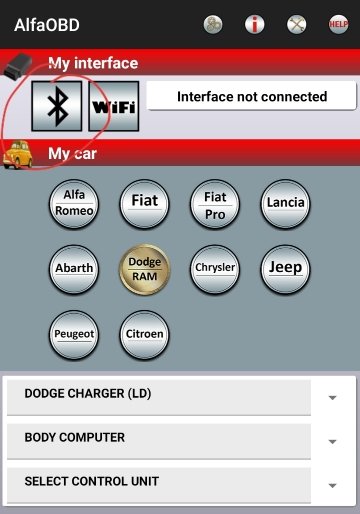

Install the MX & press the reset button, then make sure it's connected to your phones bluetooth, then connect in the app... then connect to the BCM.
Bob
I had a little time when I got home so I did the reset and tested, same results. so I downloaded the Alpha OBD demo version and tried it, it connected and acted fine. So I guess I’m going to delete the software and reinstall on my android tablet and test again when I get back home.

After I reinstalled that Alpha OBD software, it connected to the body computer and I disabled the cargo camera, now my reverse camera works.

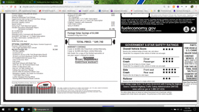

Hi,
just wanted to see if anyone can confirm or deny that the 4 digit number at the bottom of your build sheet is the same number needed to program a keyfob?
