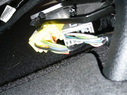

So wait regular cab tradesmans have the wireing already?
Yes the regular cab trucks seem to have all of the wiring pretty much for everything. We found this out when 00/RT installed Heated/Vented seats in his regular cab Express. We assume it's because they build so few regular cabs that there is not enough need to make a separate harness for the different trim levels and configurations like they do for the Quad Cab and Crew Cab.
Like Rick'sRam said, regular cabs usually have most of the wiring. I have a '17 2500 RegCab. It came with cloth bucket seats with power seats only on the drivers side. Leather seats, heated seats, ventilated seats are NOT available from the factory in a heavy duty regular cab. Reading through RicksRam's thread I found out how to do it and what to look for as far as wiring. I pasted below screen shot of the wiring under the driver's seat in my RC. It was plug and play as far as the seats go, the passenger seat wiring was all there as well. Then of course had to activate them in the BCM. If your wiring under the drivers seat looks like mine (the yellow plug is key) you are good to go............

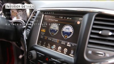

I don't think the "off road pages" does anything for our trucks. If you enable "off road package" in both special packages sections in the BCM near the top, it will give you the Rebel splash screen on boot of the EVIC.
figured as much but thought I would try. Was trying to see if these screens would come up.

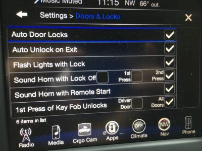

Has anyone seen any way to make the truck unlock the doors when you throw it into park? Had a few GM vehicles that did this and I kinda miss it. Haven't found anything in my searches.
I just checked my truck and when I have the auto unlock feature selected on my screen it automatically unlocks all doors when I open the drivers door after I shut the truck off. It doesn't do it when I put the truck in park but it's pretty much the same thing. The autolock feature locked all the doors at 15mph. 560531720.jpeg

If your seat harness looks like the one in the picture you should be set.

I just checked my truck and when I have the auto unlock feature selected on my screen it automatically unlocks all doors when I open the drivers door after I shut the truck off. It doesn't do it when I put the truck in park but it's pretty much the same thing. The autolock feature locked all the doors at 15mph. View attachment 142813
Yeah I've got that too already.
Was just wondering if in all this hidden stuff we now have access to there was a way to make it auto unlock on park. For now it seems the answer is no.
Oh well.
