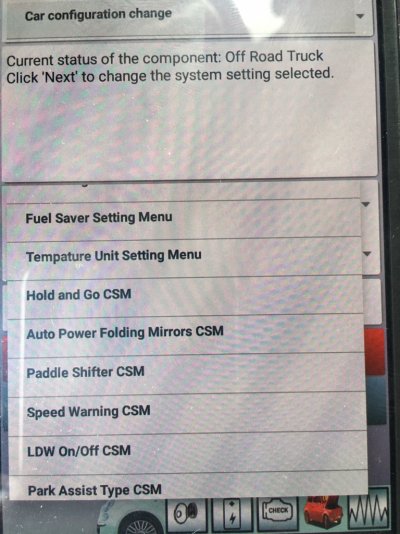

Still playing catch up but are you all referring to the “auto power folding mirrors csm”?

All the way to the bottom with the other csm settings. It’s going to take someone with the correct door modules and switch to verify though.

That’s correct. I can’t get the setting to even show on mine under settings/safety and driving assistance. Unless it’s one of those that take a while to set. It should be right above or below tilt side mirrors in reverse on settings I would think.

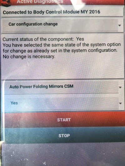

Auto Power Folding Mirrors CSM
Still doesn’t show on mine after 20 minutes of sitting. Of course, I think my tilt in reverse took much longer before the setting displayed on the 8.4.

Ok, great! Look above your last. Posted screenshot of location.
