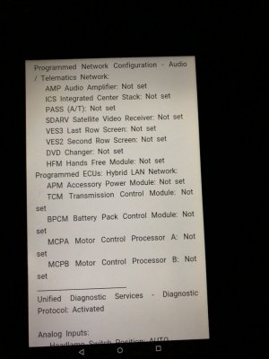

I do not know what I did that I stop working my audio control and my voice control and for some reason I do not find the things that change

As stated its most likely your clockspring or your steering wheel harness. It most likely has nothing to do with anything you did. I would reccomend checking all your wiring and pulling the steering wheel and checking the harness. If the harness looks ok there is a good chance it could be the clockspring.

that means that my clockspring does not work anymore

Yes there's a possibility it is your clockspring because all of the electrical connections that come from a steering wheel go through the clockspring. Since none of your steering wheel controls seem to be working correctly it is most likely the steering wheel harness being damaged or not being connected properly to the clockspring or the clockspring is bad. You did say your steering wheel controls plus your audio controls are not working correct?

but because I stop working only what is the radio and everything else works to move through the cluster and cruise control

I would still think it's something in the wiring or the clockspring.

my problem has been solved it was not my clockspring I had only these functions sdarv satellite video receive and hfm hands free module dvd charger wifi pass and call pass after disabling everything works correctly I just have another plobrema my high light does not work with the multi switch when doing it backwards as normal mind works only works if you pull towards the steering wheel
