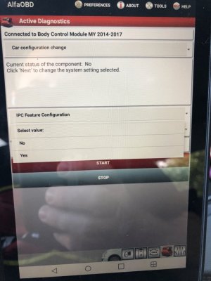

7F521463-F852-48B5-9D9E-A0AF76B2D447.jpeg 8835CCD0-08CC-4884-9CF6-26062898BA74.jpeg Anybody know what these settings change or enable?
One is for features of the instrument cluster, but what features? And if I enable/ disable the setting what happens?
The other is for splash screen type. Currently set at “no” but there lists all different types.

View attachment 144236 View attachment 144241 Anybody know what these settings change or enable?
I wonder if the IPC Config one is for the EVIC based config menus that you get when you have the RA1 Radio and therefore don't have the settings menu on the radio?
