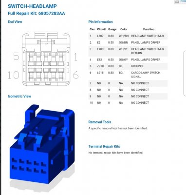

justinkyleo
Jun 9, 2017
30
26
Waynesville, NC
Cummins 6.7
Possibly useful info for factory cargo lighting... The cargo lamp switch is momentary connecting pin 6 (cargo lamp switch signal) to pin 3 (headlamp switch mux return.) They'll also cut on by momentarily grounding pin 6, but Idk how bad that is for the circuit inside the bcm. Either way, it's not too hard to pull two small gauge wires back to the bed and place a redundant waterproof switch to turn them on and off from back there.
