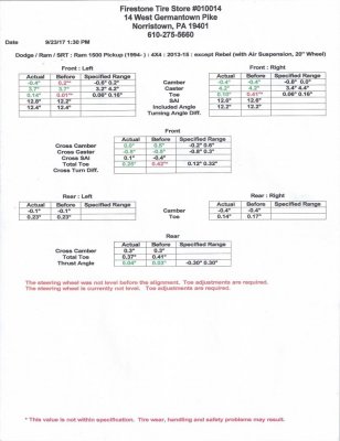

Hmm, Interesting info here. I am on my 3rd set of tires now with only 56k miles, with rotation about every 5k miles. The OE tires made it to just about 30K miles, 2nd set made it to 56K. New set installed this weekend, and were pro-rated by Firestone as the tires have a 55k treadlife warranty. Firestone also did my alignment when they installed the 2nd Set, but I did not have them do a new alignment on this 3rd set as I am suspect of their skills.
Also, now wondering if the AirRide suspension is causing excess tire wear. Not sure if Firestone was intelligent enough to put the suspension in Alignment mode and if that has any impact on the alignment settings? Specs from my last Firestone alignment . . .

Air suspension equipped trucks have to be in alignment/aero mode. It absolutely will change the alignment if it’s not put in that mode.
That alignment looks fine to me. The toe isn’t even on both sides but not enough to cause any tire wear.
