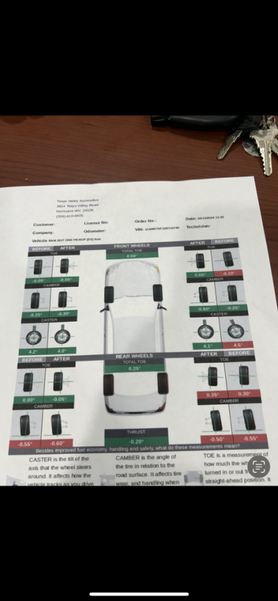

I have a 2017 1500 with a 2 inch leveling kit with 33x12.50 ridge grapplers and 20x12 wheels..I’ve had two alignments done and the truck is still eating at the outer tread and it wants to pull one way or the other, mainly to the left like the steering wheel is off centered. Everything is tight on the front end other than the passenger axle having some play. Any suggestions? I’ve also attached a pic of the alignment sheet

Where are you getting the alignment done. I’ve had 0 luck with alignments anywhere except the local dealer unfortunately. Most techs are young and lazy or just don’t know how to properly do an alignment. Even the local off-road shop can’t seem to get it right on my truck.
It was two different shops, not dealers but locally owned businesses.

I’m having the same issue after install 2” leveling struts new upper and lower control arms that came with ball joints inner & outer tie rods, sway bar links, drivers side cv axle and intermediate shaft, both wheel hub assemblies and only thing I didn’t change was drag link and passenger cv axle and after getting it aligned multiple times and my buddy owns the shop so he even got his machines software updated and got it recalibrated and my truck still pulls hard right
