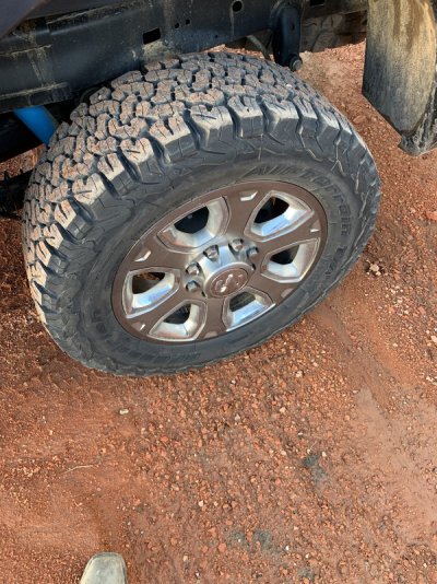

ok. Son was just here. He said he got over 50,000 on his K02's so truck would have had at least 62,000 on it when he got his current tires. He told me the brand but I never heard of them and forget what they were but he said he has 90,000 miles on it now so he has about 28,000 on these and said they are holding up well.
Here is a pic of the K02's right after he got them. They were stock size

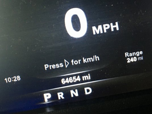

Netter yet, I can tell you exactly how many miles he got on the K02's...lol. He got them with 12,000 mile son the truck and I went with him to Baytown and took pics of the speedometer to check gas mileage so this should be very accurate.
So he got the tires at 12,000 miles and this pic was our first stop about 150 miles after we left so probably about 64,500 when he got the new generics put on. So thats about 52,000 miles on the K02s and so far 25,000 on the generics and he said they are still in good shape and said I should buy them for mine since they were 1/2 as much and wore just as good
