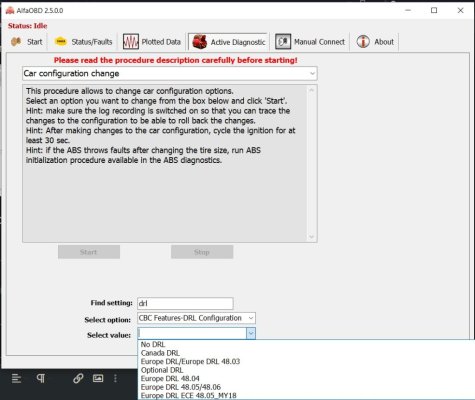

I have made changes with AlfaOBD so that my DRLs are an option in the radio menu and have the ability to turn them on or off. The default DRL for my truck is front signal lights.
The DRL are always enabled and I have the dashboard light sensor covered with black electrical tape so that the headlights come on when the sun gets low.
IIRC, I made the following changes to DRL settings;
Switched from Canada DRL to Optional DRL.
Cust.set.menu 1 -Daytime running lights CSM present /yes
And, drl/ ECUConfig 3 -Customer setting option present/ yes.

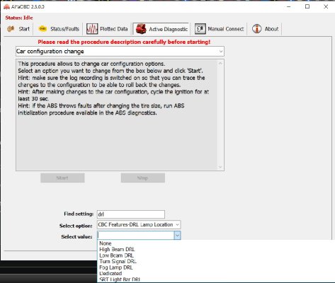

AlfaOBD does allow you to select your preferred DRL source and to add a setting in the radio to enable/disable DRL, as described in my earlier post.
As far as I know, there is no option to add switching the DRL to a different source using the radio.

So, tried to set drl to optional. Will not do the change. Keeps reverting to DRL Canada. Also won't do the ecu configuration 3 change. Gives me an error message that says the change is outside the parameters. It did accept the middle change,Custom set menu, but the option does not show up on my settings pages. I am betting this is failure to change 1 and 3 is due to the Country code being Canada. Mine is a 2021 2500, did it take on your pickup?
That's odd.
Is the AlfaOBD updated to the most current version?
Are you power cycling the start button after each change maintaining the engine off?
I've made several changes with & without power cycling the start button. I don't recall if the DRL lights updates included power cycling.
I've also updated my AlfaOBD twice since making the DRL changes, so the option wasn't new for my truck.
I use the Windows version of AlfaOBD but that shouldn't matter.
In AlfaOBD I'm currently using; My2019PowerNet under the ECUs/Body Computer with my '21 Warlock.
I believe that the DRL enable/disable switch in the CSM menu required a few on-road power cycles before it appeared.
PS; I never changed the country code setting on my truck. I'll try to get more pics tomorrow.
