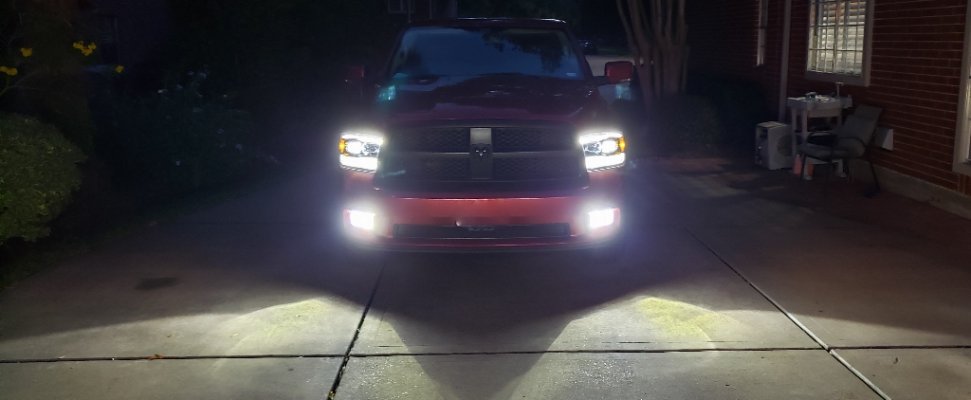

Hey guys, I’m turning to you guys in hope that maybe someone might know the answer to this issue I’m having with my new alpha ex headlights on my 4th gen truck.
just picked these up two days ago from Amazon and installed and swapped over my leds and I’m getting a weird light pattern and I’m not sure where the issue lies. I’m uploading some photos as to what it’s doing.
any suggestions would be greatly appreciated.
This would be the first time I’ve ever owned projector style headlights

They might not be clocked correctly, that's what it looks like to me ... make sure the flat side of the bulbs when they are inserted are vertical and not horizontal ... then you still might have to adjust them a bit

What bulbs did you swap over? Unless you previously had alpharex housings or another housing that took an h7, the ones you had will not fit. If you did install h7, you need to clock the bulb with the housing out until you get the best pattern. Just a fair warning, the high beams are going to suck regardless.

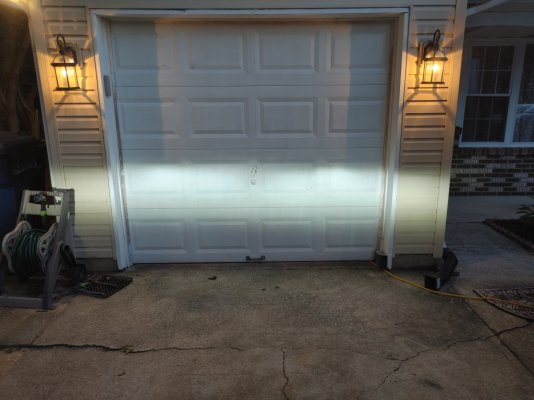

From what I understand LED's in projectors may not be the best combination. LED's work best in reflectors. HID's work best with projectors with only a few exceptions.
These are my LED's in my stock reflectors, clocked properly.

Its not clocked correctly. Turn them until you get best output then put them in.
LEDS work great in alpharex housings. I rocked them for years
