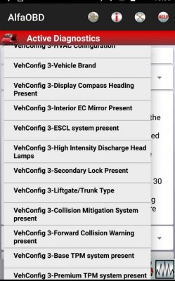

I have Alphaobd and I'm trying to get my HID lights working. I can't seem to find the HID enable option. Just the LED option. What should I be looking for?

In the Body Computer, Change Car Configuration listed as; VehicleConfig 3 - High Intensity Discharge Head Lamps
I found it. Turns out it was already on.
