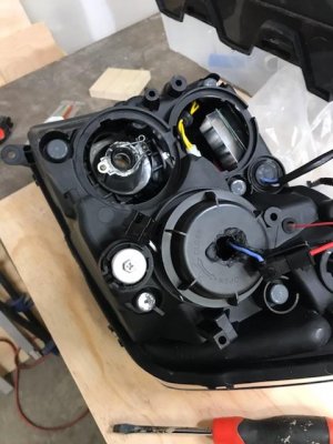

So I got home, grabbed some tools, and started tearing about the grill and headlights. My anger grew especially when I saw that they stuck the gray DRL wire in to my fuse box in an open socket not even sandwiched with a fuse to help holdnit in place.
The HID kit was hanging down towards the wheel well not even secured same with all accompanying wires and then they didnt even install the HID bulb correctly in the housing or through the dust cap with a grommet that came with the bulbs. My Hikari Ultras were not installed correctly and fell out when I removed the headlight. The fog light were not clocked properly and wow what a difference when they are.
Just an overall lack of knowledge and sloppiness forced me to call the owner and demand a refund. Once he saw the pictures he agreed that it was one of the worst jobs he has seen. So after removing the headlights, clicking the led bulbs correctly, mounting and securing the hid kit, and properly tapping fuse 66 for the DRL my lights look 1000000% better. The cutoff is almost perfect. I as a noob stepped down the cutoffs instead of making them level but I'll fix that tomorrow. My only issues now are a Parking Bulb out light when I use my turn signals and the 5000k hid bulbs are too yellow and dont match the rest of the bulbs and it sticks out like a sore thumb sonic ordered some 6000k hid bulbs to replace them.

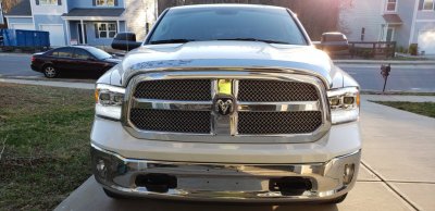

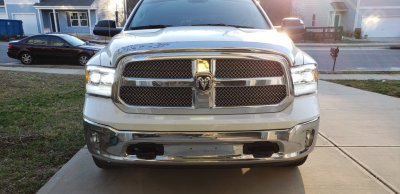

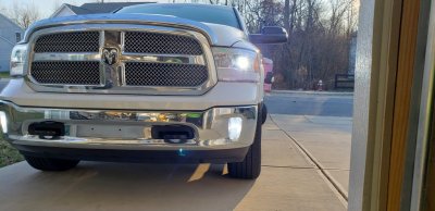

Here are my output shots. Not the clearest but what a difference over stock. I'll adjust the lights tomorrow so they are even across and not stepped down. I'll update once my new 6000k HID bulbs come in.

It doesn't even look like they drilled the cap, it looks like they used a heating/soldering iron to melt a hole through it....WTF

I like ‘em.
Daytime pics stepped back/away from the truck?
Let’s see what they look like!!

I would also try to get AlphaRex to send new covers for the holes. I have the exact same setup as you and all components fit nicely inside the headlights. With the holes they made in the covers you will get moisture inside (unless somehow sealed).
