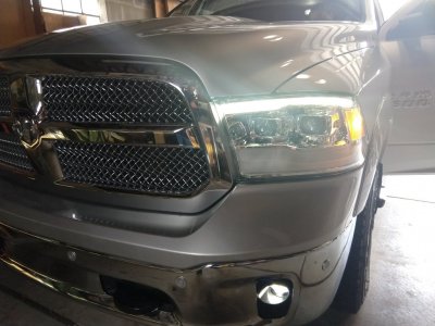

I figured this time around, I didn’t want to mess with any projectors, kits, or bulbs. Although, I did open them up to paint them.
The only thing I can’t stand is the stupid “light show dance” the DRL strip does (same for the 5th gen style linked), and there’s no way to disable it. I use DRL dropout for my turn signals, and every time I’m done using the turn signal, that ridiculous Knight Rider light show happens to the DRL when it comes back on.

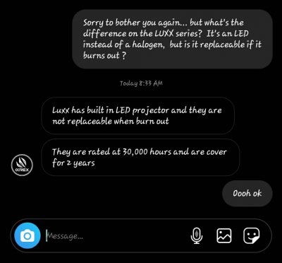

Only thing about the luxx series is that they are built in leds and if they burn out you can't replace them
Alpharex confirmed that earlier today Screenshot_20200902-083726_Instagram.jpg
