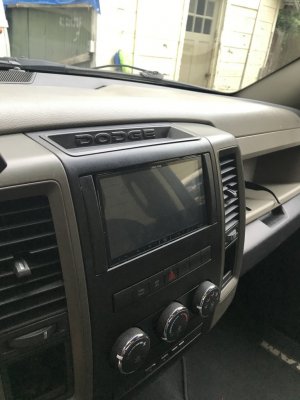

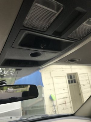

Finally got around to wrapping up my w650 stereo install. I’m supper excited about the way it came out. It’s flush mounted and sleek looking and I love all the features especially the car play. Also, I ran the microphone cable up the pillar hidden behind it and attached the microphone to the empty rear window switch I had in my overhead console. So far I don’t have any complaints and I’m super stoked about it.

Looks nice. I'm still on the stock system. How hard was it to get the mic all the way up there?
Honestly that was the easiest part since the wire is so small. Just pulled the pillar off and the overhead console down, tuck wires and hook it onto the piece of plastic. It functions awesome up there too for voice commands and phone calls...perfect location IMO
