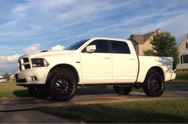

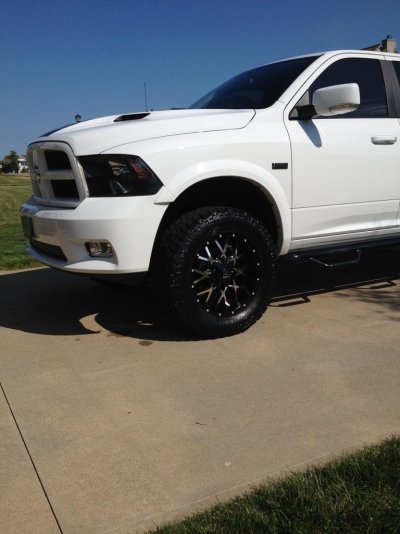

No possible way he could talk down on BDS ... They are arguably the best lift company out there ... Lifetime warranty, and the powertrain coverage ... That being said, I wasn’t planning on heading offroad, So I went with the Zone 4”F/3”R with Bils set at 1.4”, and couldn’t be happier ... Had the Zone shocks rear, but have since replaced them with Pro Comps ... Factory springs up front ... The ride is awesome, and I handles great ... Nothing close to what your guy described57a0a9c3862150f0857198c93b044c44.jpg

#2 sounds perfect .... I was the same way ... Wanted 6” but it had to go in the garage ... OH winters .... Zone 4” with Bils at 1.4” and 3” rear springs, rollin on 35’s ... And I slide in a standard 7’ garage door, with 1-1/2” clearance ...

Thanks ... It’s been great ... 2012 with 125k .... Should there be issues with some suspension parts, you go back to them, but they are great .... And they don’t **** you on price ... I’ll be lookin for a 2021 or 2022 Gen 5 .... And I wouldn’t hesitate to go back with Zone/BDS ... 2012 had the flat puck ... If you have the fin, you lose another inch or so .... I have to be careful of snow puled in front of the door .... Or I modify my roofline ... And not in a good way
