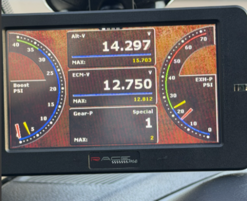

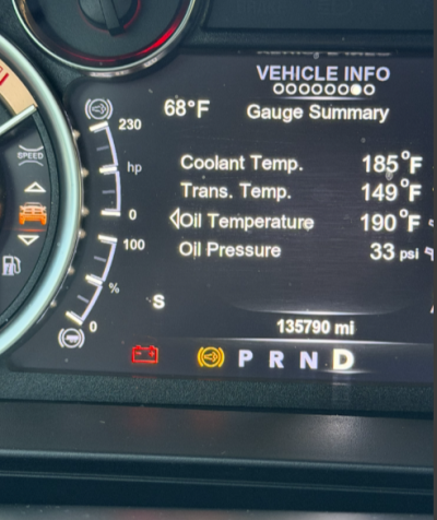

It's been down in the 30s and 40s for the past week so no light. Got up to 68 here yesterday and it did it again. Finally got some pics. I was out in town, so no meter with me. When I restarted the truck at home, it was back to normal. No light this morning.
First pic is with the batt light on. Second is how it should be.
