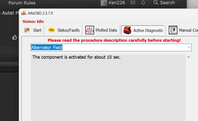

Would like to actuate the field while not running; to check Ecm .
Having intermittent alt function

You will need a proper scan tool to perform that function. One that has true bi-directional controls like the WiTech has. There are plenty of aftermarket scan tools that can do what you are wanting to do. The Autel Maxisys MS906 will do it as well as many of the lower prices Autel devices.

Probly a little late to help, but I just saw this post
You'd have to try it to see when, how and what it works. But:
