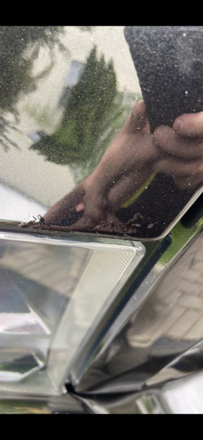

So my beloved 2018 Big Horn 1500 5.7 QC Hemi has developed a small bubble in the paint along the front edge right above the passenger side headlight. Truck is washed weekly, spray waxed, hand waxed, ceramic, etc. The truck is immaculate inside and out. I take very good care of her so you can imagine my shock and dismay when this paint flaw reared its ugly head.
Anyway, I called the dealer. They said they would repair it and the repair would be covered under warranty. They would give me a loaner for the week they had the truck. I said ok, and made the appointment. As the appointment got closer I began to stress out about the thought of letting the stealerships body shop handle this repair. First of all, these guys can barely get an oil change right. Second of all, a buddy of mine who owns a body shop looked at it and said the right way to do the repair is to remove the hood, repair it, then paint both sides of the hood before re-install. That was all I had to hear. All I can picture is them removing my hood, letting the truck sit somewhere with the engine exposed, dust from the body shop everywhere, the hood never lining up correctly again, and the PXR paint which is that black granite, that sometimes looks black, green or brown depending on the light, with a ton of metal flake in it, not matching the rest of the truck.
Needless to say I canceled the appointment. My buddy who owns the body shop who I trust with a bunch of my vehicles, who by the way painted my fender flares, hood scoop and cab spoiler to a PERFECT match, is gonna do the repair. $750 and of course no loaner, but I know the truck will be done right, and he is literally around the block so once he removes the hood I can bring the truck home and cover it in my driveway.

This is what I’m dealing with. I agree. Something is going on probably on the underside of the hood that caused this. I know my guy will do the right job. He is meticulous and very thorough. I can’t say that for any dealership I have ever dealt with.

That was most likely caused by a chemical reaction to an APC ... if you did any kind of paint correction, buff or polish and you left the polisher on that spot for a long time you compromised the paint and coating, an APC got underneath the paint and reacted causing the bubbles ...

Lol. I get blamed for everything. You sound like my wife. Anyways, whatever caused it, it’s definitely a bummer. I just used the last of my vacation time for this year, so next year I’ll use one of my weeks and give the hood to my body shop guy so the truck can sit safe in my driveway covered for the week while he repairs it. I’ll just stay away from that spot with the buffer next time I polish her, and if what you are saying is true, hopefully it won’t get worse to the point of perforation.

Paint does not bubble on its own. What is the underlying cause? Unless you fix that you'll be back at it in a few years. It would be helpful to have a pic.
Unfortunately I see this pretty often. 42 years in the collision repair industry. People come in out shop saying that their hood is rusting. The hood is aluminum. It's nothing you did. It's coming up from the bottom. There was some form of contaminant on the hood or trapped between the outer hood skin and the inner structure when the hood was manufactured. Aluminum is very sensitive to this sort of thing. Strip, clean, etch prime and fill if needed, seal that seam if needed, sealer, color, clear. I'm guessing that your buddy knows all about it. The dealership body shop probably does as well. I still think you are doing the right thing by having someone you trust fix it.
