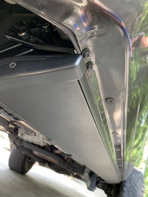

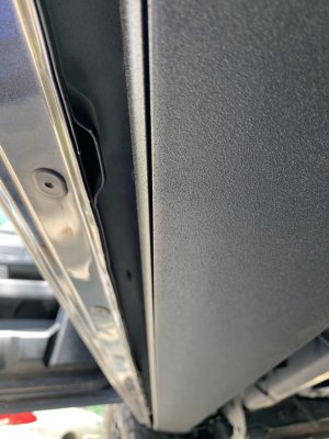

I’m not impressed with these amp boards, the build quality is top notch but the installation is crap. There is nothing to the mounts except 2 bolts and 2 rivets (which I haven’t done yet). The boxes are marked for drivers and passenger side, so how is it that they are miles off?

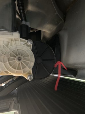

The drivers side goes up under the truck but will not come down because they hit the water gaps in the pinch weld.
The passenger side hits the pinch weld and stops there.
There is no adjustment on these so what could I have done wrong? Or did they put the wrong parts in the kit?
I may send them back and get RBP as I have wasted enough time on this crap.
Drivers side hits these
Drivers side
Passenger side

I had to grind some of my pinch welds, and primers and spray bomb over the grinded area on mine. They were hanging up in a few spots on the pinch welds.
I’m not grinding paint off my truck, these things are $1,400, they should fit. I’ll send them back before I do that.

Check out the pic of the passenger side, it’s about 7/8” from even going all the way up.

There no way I’m going to be able to move the passenger side in 7/8” buy loosening and retightening bolts. Check out the pic, it’s not even close.

I’m not sure how I can gain anything to move them toward the centerline of the truck, the brackets have to mount flush against the rocker. So if they were in a bind or something that would make sense but mine are overlapping the pinch weld by over 1/2” on the passenger side.
The only thing that would move them in would be to move the bracket in.
2A987412-DF09-4E24-9458-AAFD53B931B6.jpeg 0FA62BFB-2CE9-4CCB-89C8-86D6CD622B66.jpeg

Took the whole passenger side back off for the third time and can’t see anything that can be done to move these in toward the center of the vehicle. I guess I call amp on Monday and see what excuses they come up with.

I installed my AMP power steps myself. I did have to put pressure on them and lightly bounce up-and-down in order for them to clear the pinch welds. It's kind of known that you have to do that but for some reason I didn't see it mentioned anywhere in the instructions. Mine were hanging up on the edge of the weld like it appears yours is. I lossend up the bolts a little and gently bounced on them a few times and they cleared. I have had them on my truck for 4 years now and they work flawlessly. I'm a pretty big guy and they don't flex at all. Now that I think about it the passenger side was the one that hung up the worst when I installed them originally.
