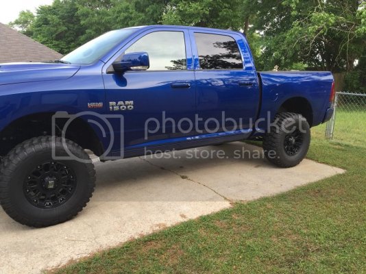

Your exactly right with the Controller, doesn't exactly fit in there like they say it should. Other than that however everything went just as expected, so far I am very impressed with how well everything fits and works flawlessly. Hopefully it will remain this way for a long time.
Retracted:
Extended:
