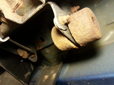

Sometimes as they close/retract, they will make contact with the pinch weld on their way by. Jump up and down on the step a few times and it should adjust a bit.

Mine did the same thing, there’s an anti-vibration canister under your driver door towards the front mount, mine was barely contacting that. I just moved it over little and now mine doesn’t ping

You might also want to check the parking brake cable it runs down towards the rear of the step on yne drivers side. There's a bracket that supposed to be installed to keep it from clanking on the step. Try having the steps open and close with the parking brake on and see if the noise goes away. There's definitely something going on. I have them on my truck and they don't make any noise at all. There's just something they're hanging up on or contacting. It shouldn't be too hard to figure out.

Problem resolved.
Driver rear side edge was not far enough to the rear. The plastic edge cap was resting against the scissor arm when it retracted sending a reverb down the hollow step. Plus it was still barely touching the pinch weld in a couple places. It might be more quiet then the passenger side now. Ha ha.
Looks like it just barely touches the e-brake cable.
