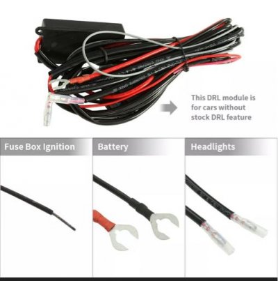

So I used the DRL relay harness that AlphaRex provided. I just used a fuse tap into F66 I believe. Then the back of the headlights have male ends that you just plug into the harness, which was pretty straight forward. d26beafec13b73f50a5f3b7fca1b6300.jpg
The DRL’s on the headlights light up white and then switchback to orange for the turns/ hazards. I didn’t go the AlfaOBD route since I don’t have the program yet.
