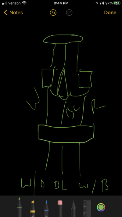

Can you draw a diagram of how the resistors are layed out and where they line up in relation to the truck's connector. And label the wire colors.

If you have a 2018 + you'll need a security bypass cable that a member/vendor sells for $50. That will allow alfaobd to bypass the security module that FCA installed to prevent vehicle hacking and anyone without it being able to make changes to the newer trucks.
As far as the diagram just something like this (don't mind the child like drawing, not easy on the phone)
So w=white. W/0=white/orange, BL= blue
