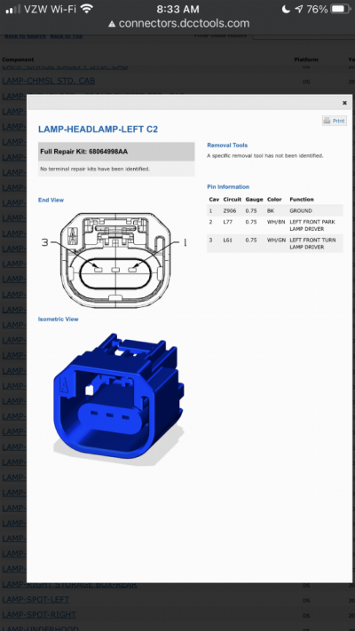

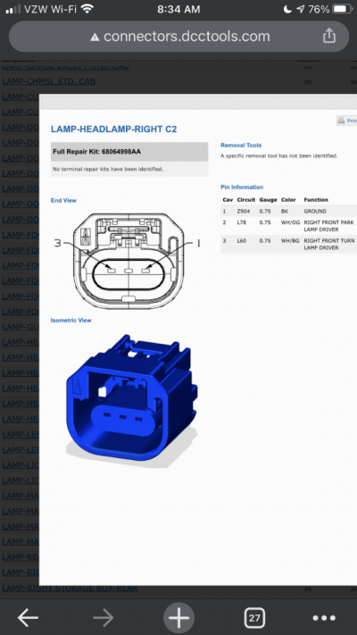

Do the parking/running lights work? If you turn the headlight switch to the parking lights do they light up?
First step would be verify that each sides connector is properly seated. If yes, disconnect and verify that all the pins are straight. If they still don't work try running 12v directly to the turn signal pin on the headlight connector. So match the pin location from the headlight connector to the truck's connector
Alfaobd is hit or miss with the g2's and the parking or turn signal out errors. If you plan on upgrading your bulbs I'd say go ahead and get alfaobd. You may end up adding resistors to the turn or parking light feed to fix the error. It looks like alpharex is working on a solution for the errors

I'd check the connectors on the right side. Just verify that none of the pins are bent or got pushed out. It's pretty easy for one to get bent. Done it before. The dash will show they are out even if they work because the truck isn't seeing the correct voltage/resistance that's where resistors come in to trick the computer.
