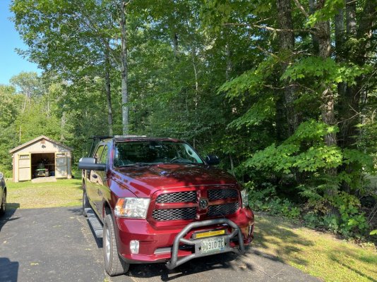

Been a while since I updated… 5100s all the way around, set at 2.1 on front, blacked out badges, Tracrac, magnum headache rack, PIAA light bars, Tyger bull bar. Putting my Tyger rear bumper on tomorrow.
