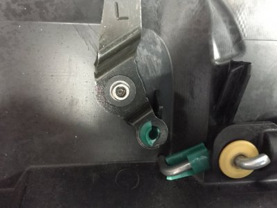

Well I just became an expert on ram box locking mechanisms My driver box would not unlock so I jimmied it with the key until it opened up. The little green grommet that holds the plunger side of the lock disconnected. Was an easy fix but very poorly engineered. I may drill a hole in the rod that runs thru the lock actuator and cotter pin it .... If I was out in the woods and needed stuff out of it I would have been screwed.
Anyone else have this ?

Mine recently wouldn't lock when I locked the truck. Then a few hours later it did lock. I haven't had the chance to troubleshoot it yet but I wonder if it may be something similar?

it has a plunger with one side of the throw with a crappy little green grommet holding it in, the other side attaches to the actual lock , also a crappy little green grommet.
I am going to mod it so they can not come out of the the holes. If the plunger fails it can still be unlocked with the key but if they are not hooked up to the lock I am not sure how one would get it unlocked

It is all put back together now , basically remove the cover , 5 10MM bolts and a few screws holding the electric plunger , it has a stupid two way throw from the plunger up to the lock.... its a stupid design
I will take some pics after I make it bullet proof. The more I think about it I may just put a circle c on the bottom of the shaft that goes into the throw

Known issue with these. Had both break on my 2014 at the same time. Went to the dealer parts department and he just gave me a bunch of those "connectors" and I kept them in the truck incase they broke again.
It's because the lock is actuated EVERY time the doors are unlocked or locked. Plastic is plastic and it'll break eventually. On the 2019+ 1500's they made it so the locks only actuate when you press the button on the Rambox.

I took mine apart yesterday and it was the same issue, the plastic tab had popped out. It didn’t appear to be broken… Yet. It’s working now but I imagine it will continue to be a problem.

Can you get a small hole drilled in the end of the metal rod and put a cotter pin through it? It looks like that would prevent it from falling out.

After I bought my new 2016 Ram 2500....I think about 6-7 months after I had similar problems with the boxes...wouldn’t unlock with flob only the actual key. Both boxes green clips broke. Dealer replaced under warranty. My prior vehicle- 2011 ran 1500 never had any problem s in the 6 years I had it

I am going to try to slide a little c circle clamp up the shaft on the back side before drilling it
